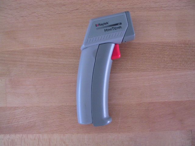

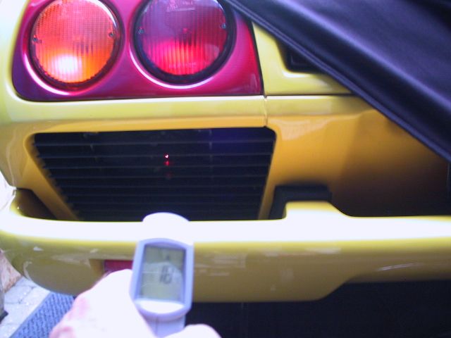

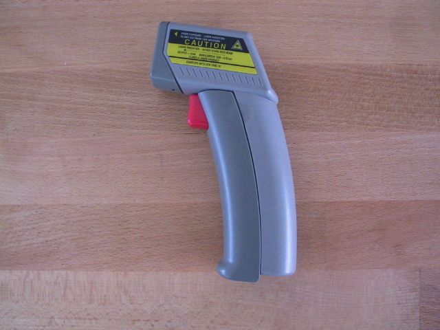

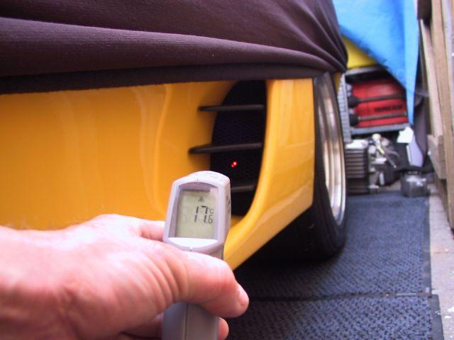

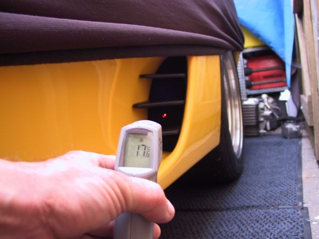

ejner Report post Posted September 8, 2007 a few months ago I had the water temp running hot, replaced thermostat and all is good. Now I got hot oil regualry runs around 120 and when pushed a bit over at the track on one stint it was right at the yellow mark so I pulled it over to cool down. On local runs driving in the power band of 4-6k it breaks 120 also. Called Lambo of Ohio and they recomended switching from 10W40 blend to 20W50 Racing syntethic. Anyone have any experience with this and the results?? Its getting new oil next week, so hopefully the new weight, racing type, and being fully syn will fix it....if not may have to look into a GTR oil cooler maybe? Is it a Diablo and what year? Maybe this can help you. You have to buy a Raytek MiniTemp. (see photo) to point out the temperatur . Take a ride in your car, so that the engine gets hot. If you then point at your oilradiator and after that on your waterradiator the temperature should be the same, If it's okay, it's an electricial problem. You can also point point at the oilpibes above the exhaust and find the temperature there. See photo. ps when I turn on the popup lights the watertemp. rise from 80 to over a 100, it's an electrical problem something need to be grounded. Quote Share this post Link to post Share on other sites More sharing options...

Auctung Report post Posted September 10, 2007 Is it a Diablo and what year? Maybe this can help you. You have to buy a Raytek MiniTemp. (see photo) to point out the temperatur . Take a ride in your car, so that the engine gets hot. If you then point at your oilradiator and after that on your waterradiator the temperature should be the same, If it's okay, it's an electricial problem. You can also point point at the oilpibes above the exhaust and find the temperature there. See photo. ps when I turn on the popup lights the watertemp. rise from 80 to over a 100, it's an electrical problem something need to be grounded. thanks, that looks cool, Ill have to pick one up its an 01 Diablo btw on a positive note, I took it out for about 150 miles this weekend and seems to be doing good now. After a long while of babing it till it warmed up, it stayed around 100-120 all the time. When I was breifly getting on it and keeping the revs higher (over 4k) it was always 110-120. Ill be going on a local meet this weekend where Ill be in 2nd with revs between 4-6k for most of the run. Last time I had troubles with the temps till I up shifted (thus falling outta the sweet RPM range) We shall see if it goes well or I still got problems. So far things are looking up though the water temp stayed between 80-90 the entire time too btw Quote Share this post Link to post Share on other sites More sharing options...
